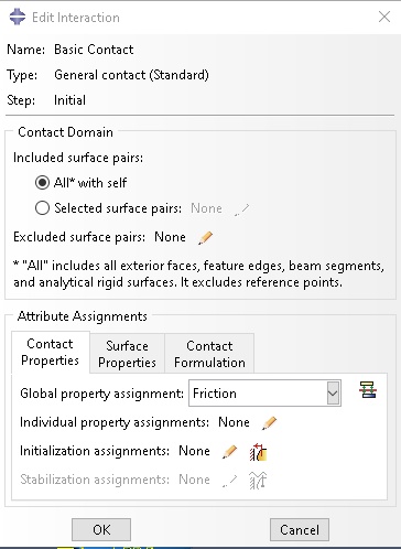

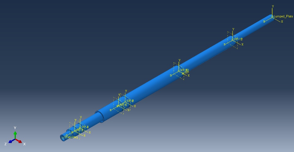

The assembly consists of three coaxial shafts (radial clearance of 2mm b/w each) with bearings placed at 6 different locations. The shafts are not in contact with each other initially, but I want them to simulate contact once they get in touch.
The steps consist the static step with ROTDYNF followed by complex frequency extraction step.

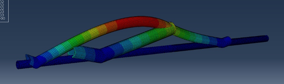

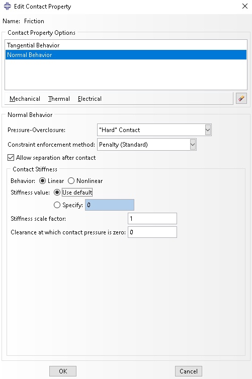

I have tried defining contact pairs, creating a friction property giving penalty behavior and hard contact too. I have even tried using general contact condition and the shafts still cross each other and I don't know why. Can someone help me with this? I want to know if this is even possible in ABAQUS, if so, how? And also, if not, how much effect will it have on my solution?
Attaching the images for reference. Thanks
3 Coaxial Shafts with 6 bearings at the points at the datum planes
Deformed Shape ( contacts not followed)
