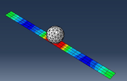

Hello All,

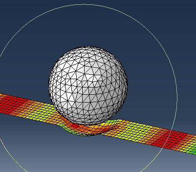

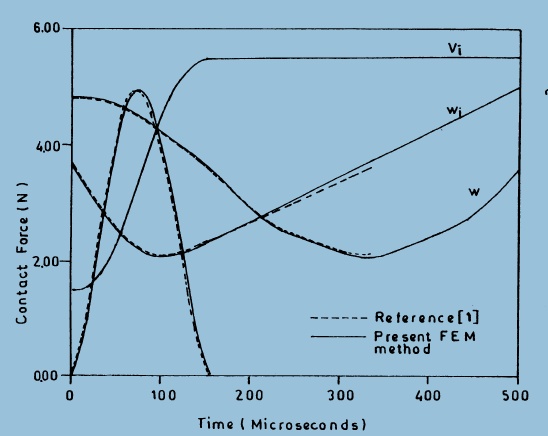

I am trying to simulate an impact problem (Simply supported steel beam impacted by a steel ball) using conventional shell element, in Abaqus explicit (Pic-4). Defined general contact with pressure - overclosure as “Hard” and “default” constraint enforcement method. The contact force (CFT3) obtained at the ball surface, is much more higher than the actual value (Which is also solved by FEM). Dimension of the beam is 16 cm x 1cm x1 cm, and ball diameter is 2 cm. I have tried to define the ball in different way, like discrete rigid, solid etc. However, contact force almost 7 times ,35 N (Pic-1) higher than the expected value, i.e. 5 N (Pic-2), In my case i am getting multiple impact as against the single impact in (pic-2).
