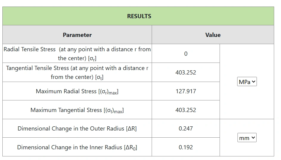

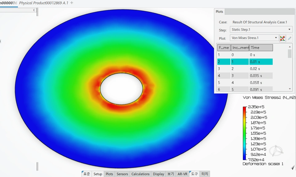

I want to calculate the von Mises stress of a disk.
How should the boundary conditions be applied relative to the hub shaft to obtain accurate results?
Currently, the theoretical value is about 360 MPa, but the simulation result shows 235 MPa.
What kind of boundary conditions should be applied?
