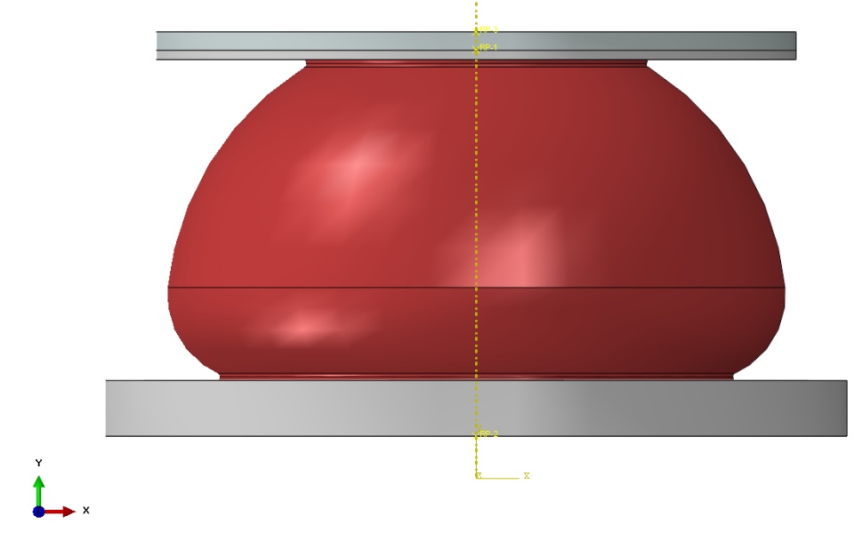

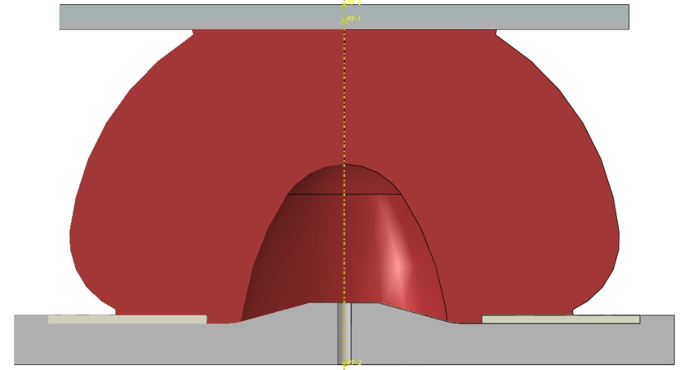

I am modelling a rubber-metal bonded item in which the profile of the rubber is like shown in picture.

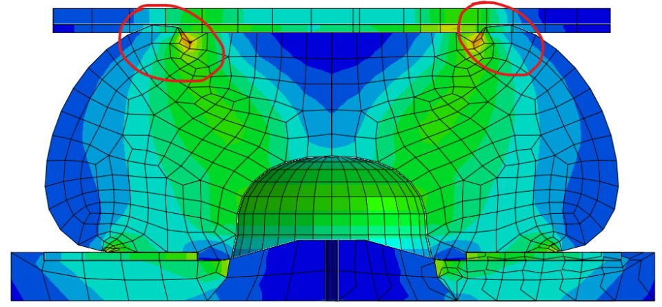

When I run the analysis with vertical loading on top, the solution has aborted due to compatibility error.
Also, the rubber portion is entering the steel plate under deflection which is not desired.
How can I rectify this?
