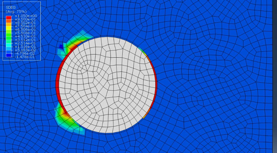

I have a model consisting of three components: Fibre (Isotropic), Interface (Cohesive Elements) and Matrix (Ductile Damage).
If I run the model without the ductile damge, it works fine (first picture) -> Interface fails

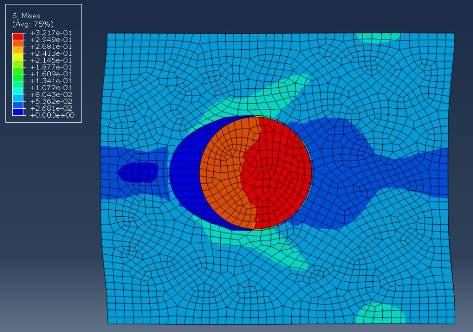

If I run the model without the interface, it works fine (second picture) -> Matrix fails

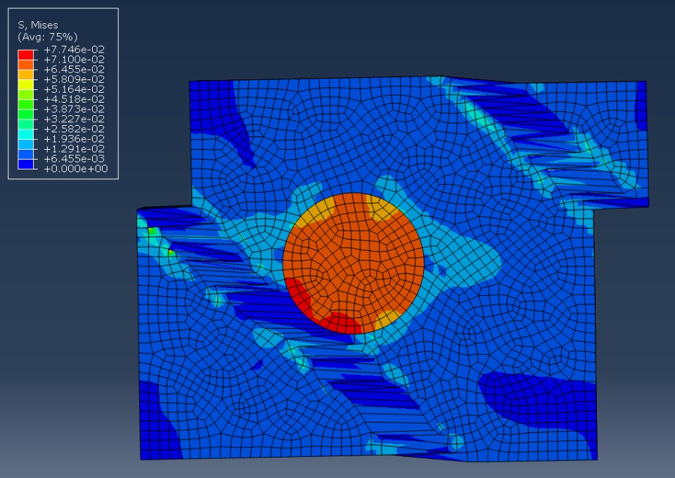

But when I run both together, the interface starts failing and failure is also initiated in the matrix but then it does not converge (third image): "Time increment required is less than the minimum specified".
I suspect that has something to do with the fact, that the matrix material starts failing at the cohesive interface.
Settings:
One part with different sections assigned to it
Units: Length[µm], Time [ms], Stress [GPa]
Periodic Boundary conditions
Solver: Unsymmetric (as recommended in the manual)
Minimum time step: E-25ms
Maximum time step: 10ms
NLGeom: On
Specific dissipated energy fraction: 0.0002
Max ratio of stabilization to strain energy: 0.05
Maximum degradation (matrix&interface): 0.99
I've spend many hours trying to find a solution but was not successful. Do any of you have a tip for me?
