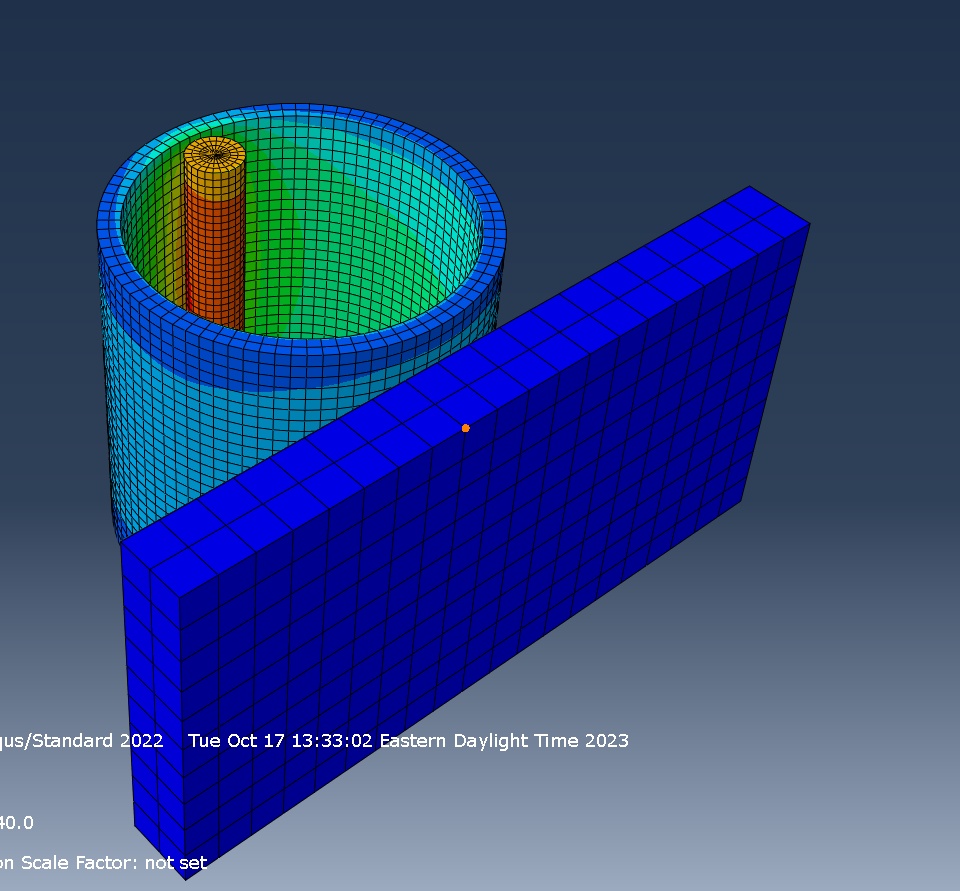

Does anyone know how to do a co-execution of a coupled thermal-electric and a dynamic-implicit simulation? I have a coupled thermal-electric simulation with a heating element heating another object. The heating element is heated using a voltage potential. The heating element heats the substrate via cavity radiation. I want the object being heated to spin while being heated. Cavity radiation is not supported in implicit or explicit simulations. I tried to set up a co-simulation but the co-execution interaction is not available in a coupled thermal electric simulation. Any ideas on how to get this to work?
