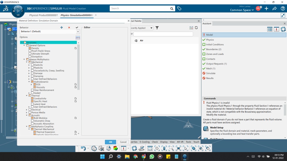

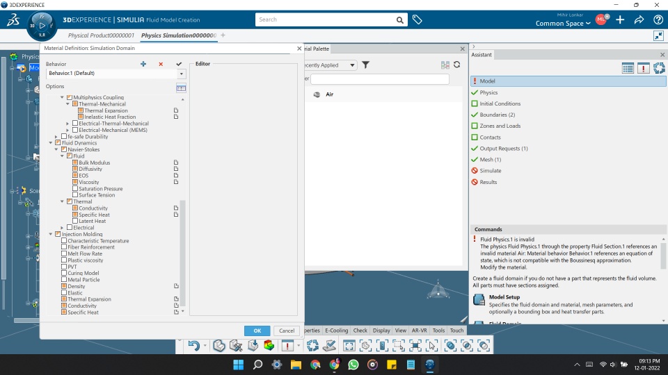

Can someone tell me which property is wrong/and or missing/and or extra

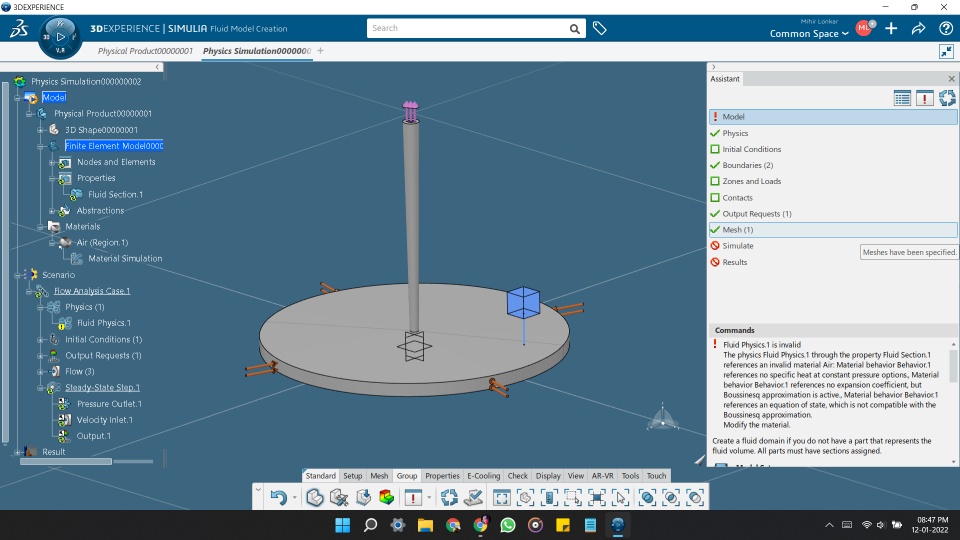

I want to simulate flow through the model along with gravity effects,temperature effects with input velocity at bottom as seen in the image.Fluid is air.
Getting an error saying equation of state incompatible with boussinesq equation.I'm new to simulation so please consider.
