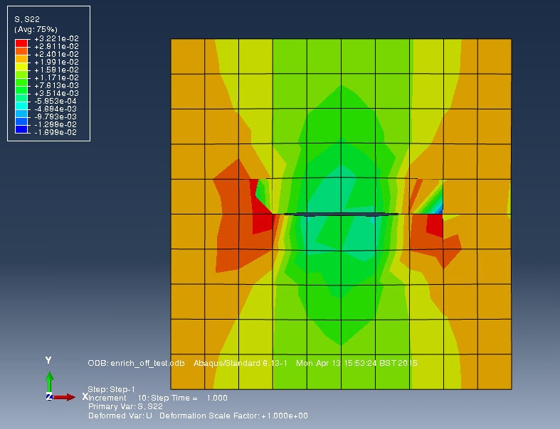

Following section 10.7.1 in the User Guide of 6.13, the crack propagation capability can be deactivated in some step. But I tried it in a very simple example through CAE and input file, it does not work.
Particularly, the problems are
1. I followed the steps in  section 10.7.1 of the User Guide of 6.13 to create the deactivation/activation, the Int-1 in the Interaction module. Submit the job in CAE. The results show that the deactivation is not be considered in the simulation. And also the input file gerndoes not include any information about the Int-1.
2. I manually insert the following line into the input files at line 334. But it does not work, too.
' *ENRICHMENT ACTIVATION, NAME=Crack-1, ACTIVATE=OFF'
Please find the CAE and input files as attached in the *.zip. I really appreciate your help. Thank you very much.

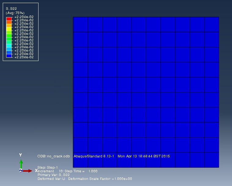

Result expected, crack is deactivated
 Result obtained.
