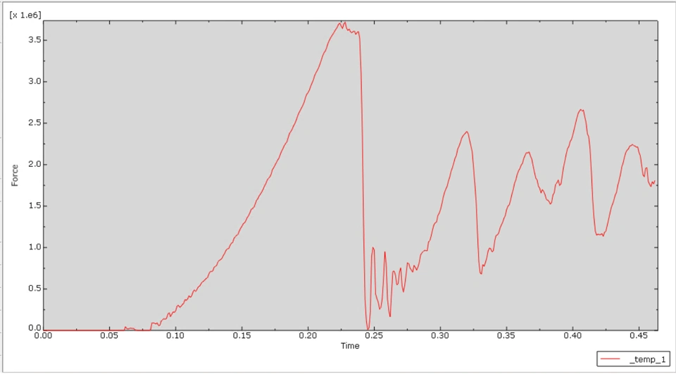

I am trying to model an octet truss metamaterial using a brittle material model in Abaqus. The constituent material is purely brittle with no plasticity. It fails at an engineering stress of 7 GPa (approximately 10% engineering strain) and has an elastic modulus of 73 GPa.

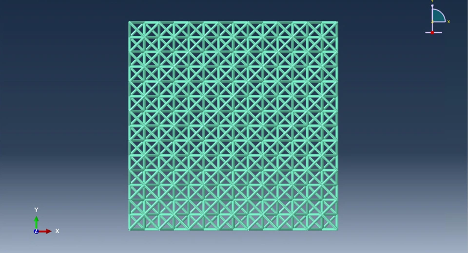

My objective is to capture the layer-by-layer failure of the octet lattice using either beam or truss elements. However, the simulation results so far do not match the expected behavior. I am using deformable body for octet and top/bottom analytical rigid bodies for compression.

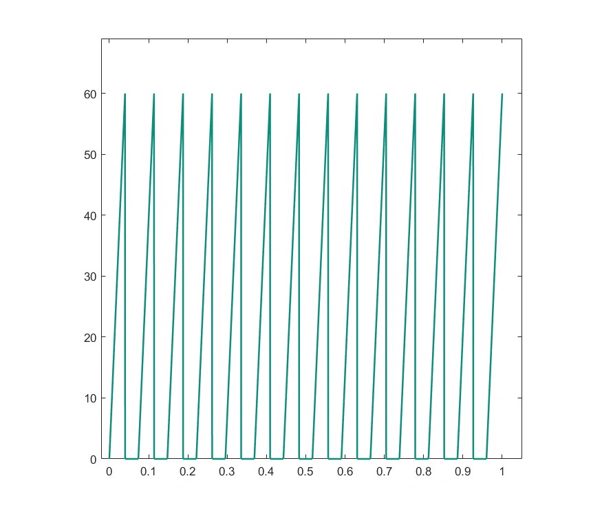

The expected stress-strain response consists of multiple distinct load drops, where each peak corresponds to the failure of half of an octet unit cell. Therefore, for a structure containing 7 unit cells, I would expect to see 14 peaks in the response. I attached Figure 1 for your reference.

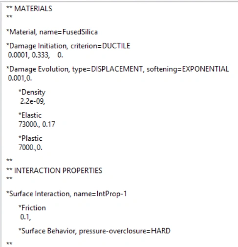

To simplify the problem, I initially modeled the lattice using beam elements with a ductile damage initiation criterion and damage evolution. Unfortunately, the simulation still does not reproduce the sequential failure behavior that I expect.
Has anyone encountered a similar problem or have any suggestions on how to model this type of progressive, layer-by-layer failure in an octet truss lattice? In particular:
  • Is there a more suitable damage or failure model for brittle lattice structures?
  • Are beam or truss elements appropriate for capturing this behavior, or should I consider another element type or modeling approach?
  • Are there any numerical settings (e.g., element deletion, stabilization, mesh density, or solution controls) that are important for capturing this sequential failure?
