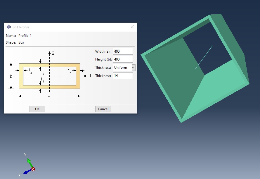

I am a new user to ABAQUS software. I am working on a simple beam problem and I would like to report the area moment of inertia and section modulus of the beam profile from the software.
Expected Moment of inertia Ixx = [b1 (d1)^3 – b2 (d2)^3]/12 = 537489045.3 mm^4
Similarly, Expected Section Modulus Zxx = 2687445.227 mm^3
How shall I check these cross-section properties in abaqus?
