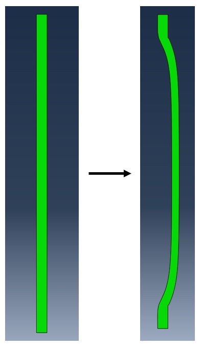

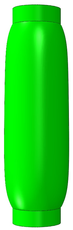

I have been using axisymmetric models in Abaqus to simulate the distension of elastomeric tubes being pressurized with a fluid (see the attached pictures). The model is one tube wall, which can then be swept to show a distended cylinder.
Next I want to simulate the response of a fibre-elastomer composite tube subject to the same pressure. I've been able to characterize this material in planar form using the Holzapfel model. However, I am encountering problems trying to make the same simulations in Abaqus because I don't know how to indicate that the fibre families are running around the circumference of the tube (i.e. partially into the screen).
