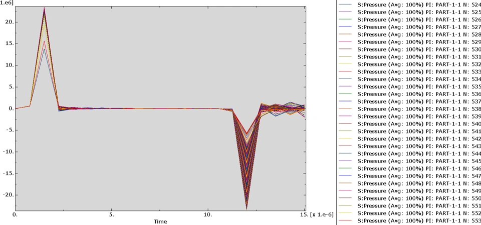

Hello,

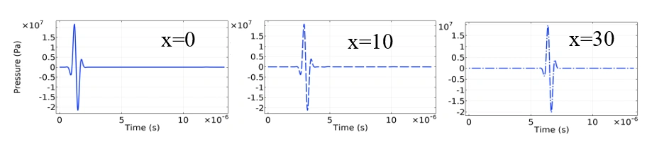

I am using ABAQUS. I need to plot average pressure vs time frame graph along the nodes through the 3 vertical lines(red) shown in the following figure. When I am trying the create x-y data using ODB field output it is giving all the pressure values together with the different time frame which you can see in the second figure. However, I want only the average pressure value of all those nodes together (like the way u can see in the 3rd figure). Could anyone kindly suggest me an effective way to do it?
