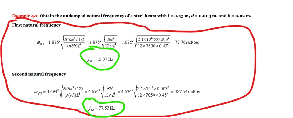

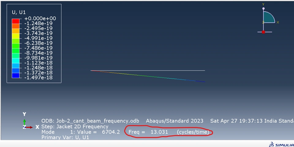

I have one cantilever beam . I am trying to validate me analytical frequency result with ABAQUS.I am getting error while matching both results. Here is my beam dimensions . What could be the reason for not matching . This is happening with me in all structure problems. Did I doing wrong modelling . Please help me out.
ABAQUS RESULT:
First Frequency - 13.07
Second Frequency - 133.70
ANALYTICAL RESULTS:
