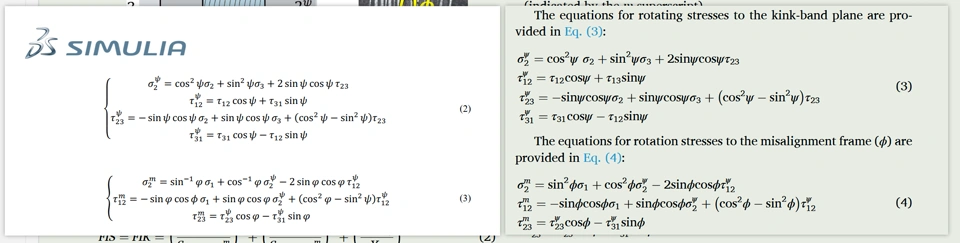

i found two type formula of Larc05,like below:
the difference is the σ2m equation ,see one is with sin(-1),but another is with sin(2),so i am a little confused,i wonder which is right or there exists some transition
