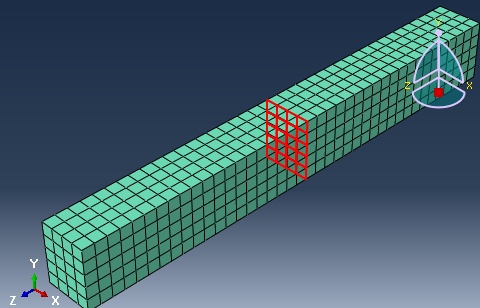

I created a beam and added a layer of zero thickness cohesive elements in the center. The beam is being ran in implicit and in compression.

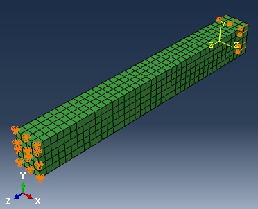

(on the left shows the layer of cohesive elements that are zero thickness) on the right it shows compressive and fixed boundary conditions.

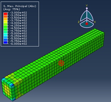

Max principal absolute stress:
continuum = -435.019
Cohesive = -448.584
I am wondering how these values are being calculated. It is unclear in the online documentation.
See photos below of 1. cohesive elements, 2. boundary conditions, 3.results
