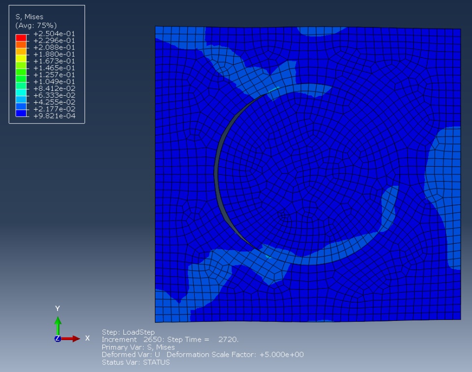

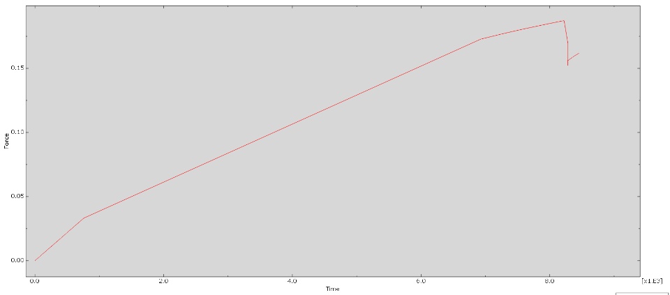

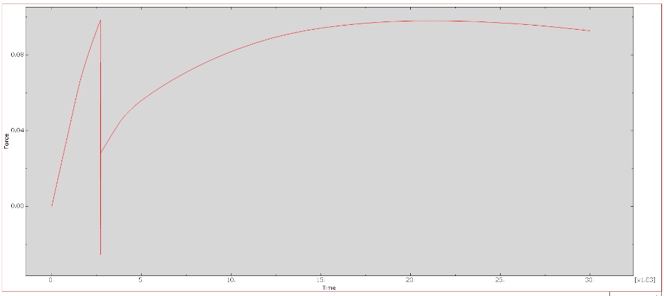

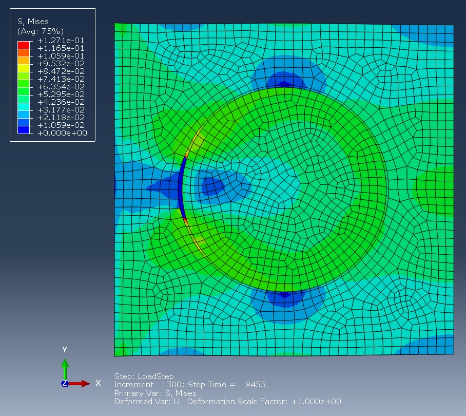

Here are the results
0.1µm (not finished)
0.0001µm Thickness Finished:And the deformed shapes:
As you can see, with the thin interlayer the part fails at a significantly lower force. Also there seems to be a stress concentration at the crack tip.
Does anybody know where the difference comes from?
