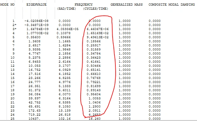

I came across a issue due to version upgrade from 2017 to 2021/2023 version.
*STEP
*FREQUENCY, EIGENSOLVER = LANCZOS, NORMALIZATION = MASS, SIM, DAMPING PROJECTION = ON
,5.0,50.0     ,,,
*BOUNDARY
MOUNT,4,6,0.0
*BOUNDARY,BASE = sec_base
MOUNT,1,3,0.0
*END STEP
****THIS sec_base I AM USING IN STEADY STATE DYNAMICS IN NEXT STEP******
which was giving me natural frequecies between 5hz to 50hz, eliminating rigid body modes due to secondary base.
but in new version, you can't set min. frequency with secondary base definition.
due to this I am forced to remove min. frequency paramter from *Frequency which results in large no. of rigid body modes (Sec.base) like below
Please help me out. I don't want to store frequencies below 5hz in .odb file while using base motion.
