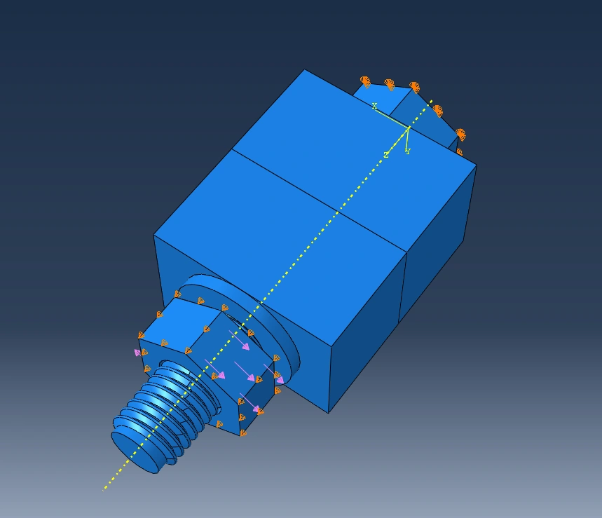

I'm researching about how corrosion effects the bolt geometry so I need to see everything clearly. I'm trying a dynamic explicit simulation by turning the nut and pre-loading the bolt but it takes soo long to simulate. I've been running it more than 3 days and it was not complete. How can I simulate this correctly?
