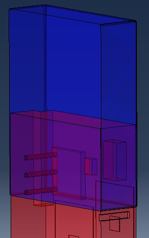

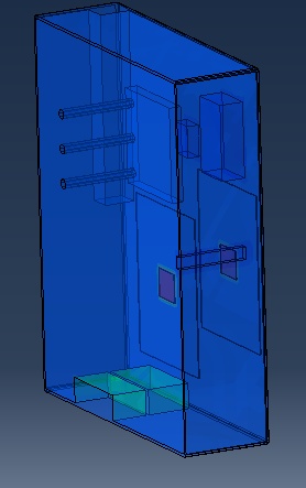

I'm trying to see stress and heat transfer by heat sources in a cabinet.
Part: Single Structure Domain, Deformable
Property: ABS including density, elastic, plastic, expansion, conductivity and specific heat
Step: Dynamic, Implicit (5 secs)
Field Output Request: basic request + NT and TEMP
Interaction: None
Load: Gravity(downward), Encastre(bottom plate), Heat sources(150, 80, 50 and etc)
I have few questions about the following results.
First 6 pictures shows displacement. 7th picture is NT11, and 8th picture is TEMP

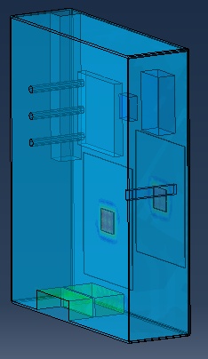

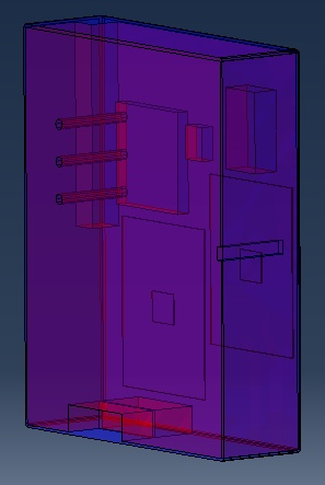

1st pic(0 sec, frame 0), 2nd pic(1.7396E-03 sec, frame 14), 3rd pic(5.5252E-03 sec, frame 16)

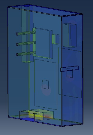

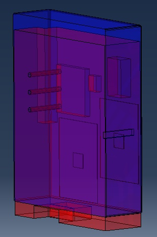

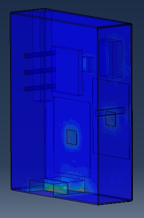

4th pic(1.1784E-02 sec, frame 17), 5th pic(9.8398E-02 sec, frame 21), 6th pic(0.2582 sec, frame 22)
then inside thingy keeps falling by 5 secs.
It looks alright by 2nd picture cuz it shows how the heat diffuses away from the heat source
3rd and 4th pics... okay...
From 5th, the red inside which I never designed(it seems like auto-generated fluid domain? idk...), starts to fall along with the gravity direction.
NT11 and TEMP results don't change over time but fall.
S result shows the stress applied to the red inside..and it falls
I wonder 1) what is the red inside, 2) why the thing was automatically made, 3) why this is falling and 4) how I can stop this falling over the cabinet.
and....one more thing!
6) Is Dynamic, Implicit step right to choose to see stress and temperature diffusion by heat sources?
