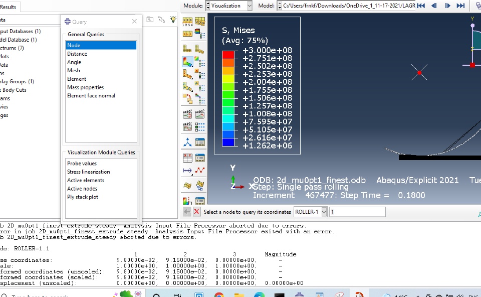

2. For the norms SSFORC and SSTORQ, I do not know what to put down as the "rigid body reference node number". As can be seen from this screenshot, the node number of the centre of my roller is 1 but this doesn't work and gives me errors when I use 1 as the "rigid body reference node number".
