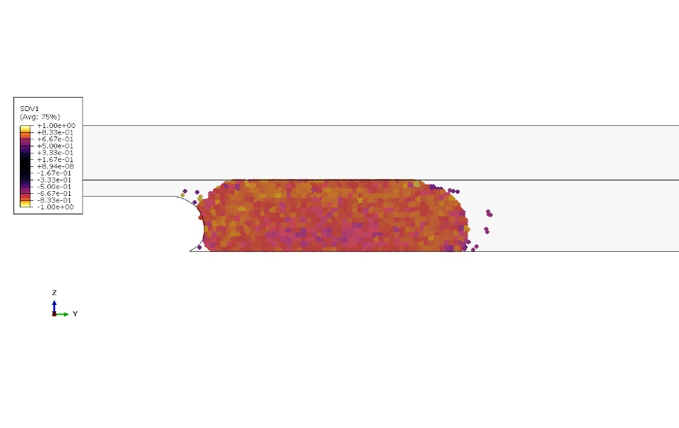

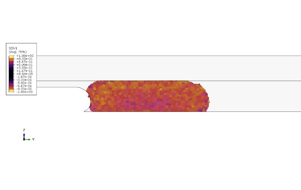

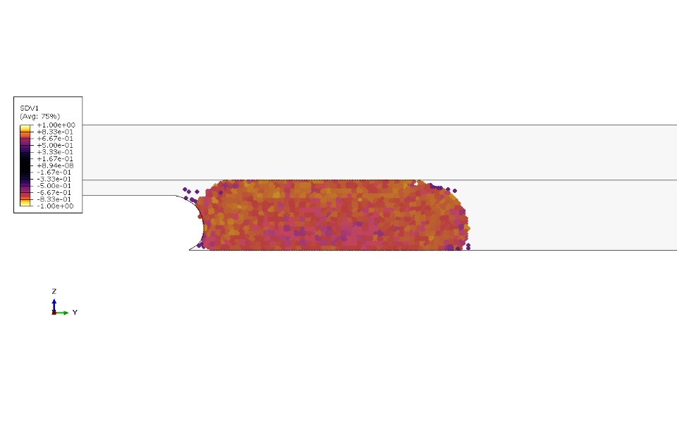

Hello,
I am currently using Abaqus 2019 to view my odb file. My issue is some particles appeared in the location that is not true (not the real location of the particle). The attached is my exported image at different time step 4,5,6. In step 4 and 5 there are some particles on the right that looks scattered, but when I exported the deformed particle location, there is no scattered particles. In step 6 is what it should look like. So this makes me think that it is Abaqus visualization issue. This is troublesome when I want to export a video or export images to make GIF. I changed some setting in the graphics option. It does not seem to help. I tried using computer with better graphics card, it didn't help. Is there other setting in Abaqus that can resolve the issue, or any work around? Thank you so much in advance.
