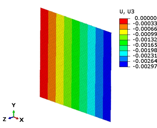

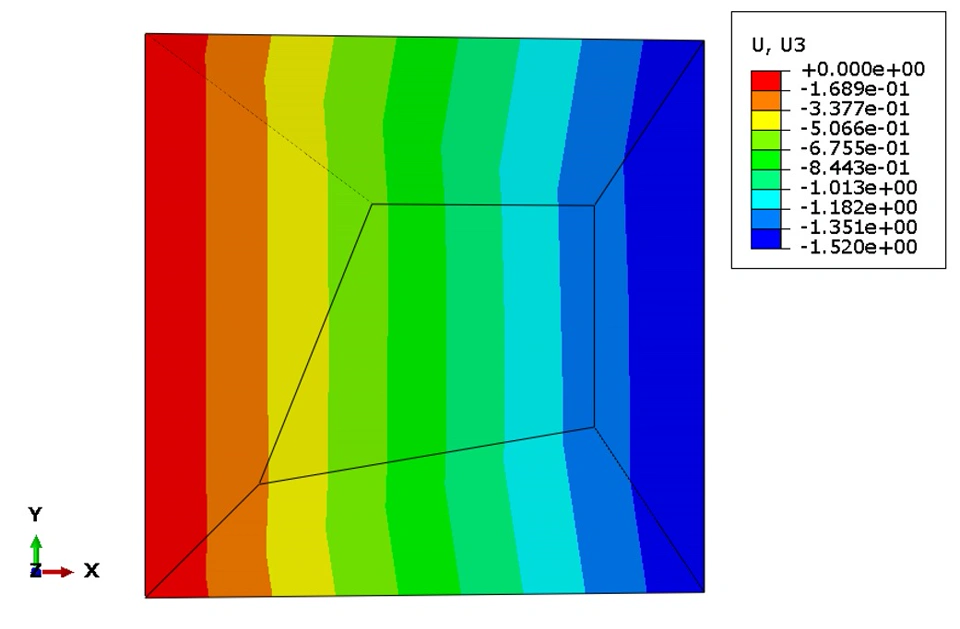

I was trying to study the behaviour of Abaqus S4 shell element. In an attempt to do so, I came across the paper by Dvorkin and Bathe as shown in the first image inserted below. I was trying to solve for the SHEAR case for a thickness of t=0.001 in the given distorted mesh. As per the paper, the transverse displacement (U3) should follow a linear distribution.
The displacement component U3 obtained for shear load Q=1  in Abaqus is not linear as shown below:
After refining the mesh to 1000x1000 elements, the displacement contour becomes linear, however, the tip displacement converges to a much different value (0.00297) as follows:

Does the above observation mean that the results obtained using 5 distorted element in ABAQUS is inaccurate? Does it mean that Abaqus S4 shell element does not quality SHEAR patch test in above Dvorkin's and Bathe's paper?
I kindly request the members to share their expert opinion in this regard.
(N.B.: For thickness t=1, Abaqus results are as per the research paper and also match my implementation)
