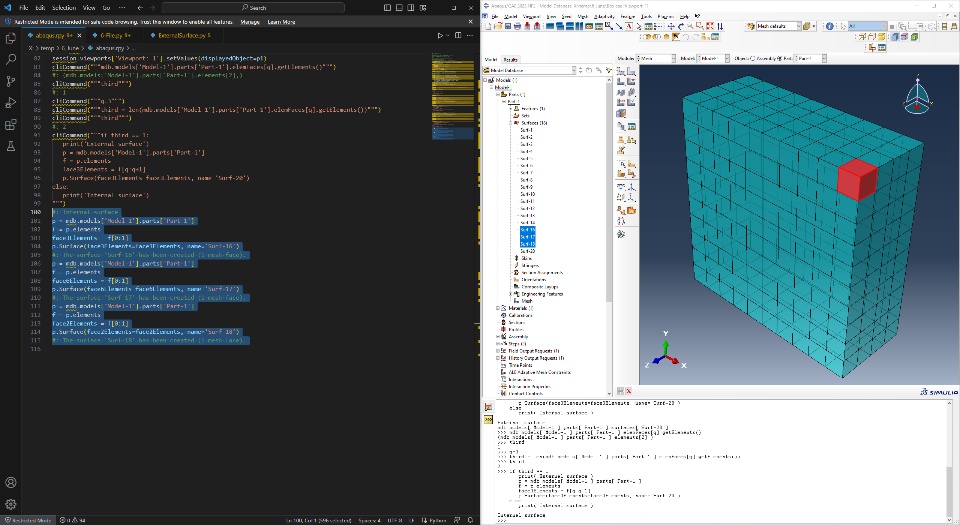

Hi! When trying to write Python code to determine the external surfaces, it does not distinguish the element faces per element, as you can see on the screenshot. I was wondering if anyone knows what to do? I wrote the following script, which can be seen below:
first = len(mdb.models['Model-1'].parts['Part-1'].elements[1].getAdjacentElements())
second = len(mdb.models['Model-1'].parts['Part-1'].elements[1].<strong>getElemFaces()</strong>)
if first<second:
   print('External surface')
else:
   print('Internal surface')
q = 17 #Just an example
third = len(mdb.models['Model-1'].parts['Part-1'].elemFaces[q].<strong>getElements()</strong>)
if third == 1:
   p = mdb.models['Model-1'].parts['Part-1']
   f = p.elements
   face3Elements = f[q:q+1]
   p.Surface(face3Elements=face3Elements, name='Surf-20')
else:
