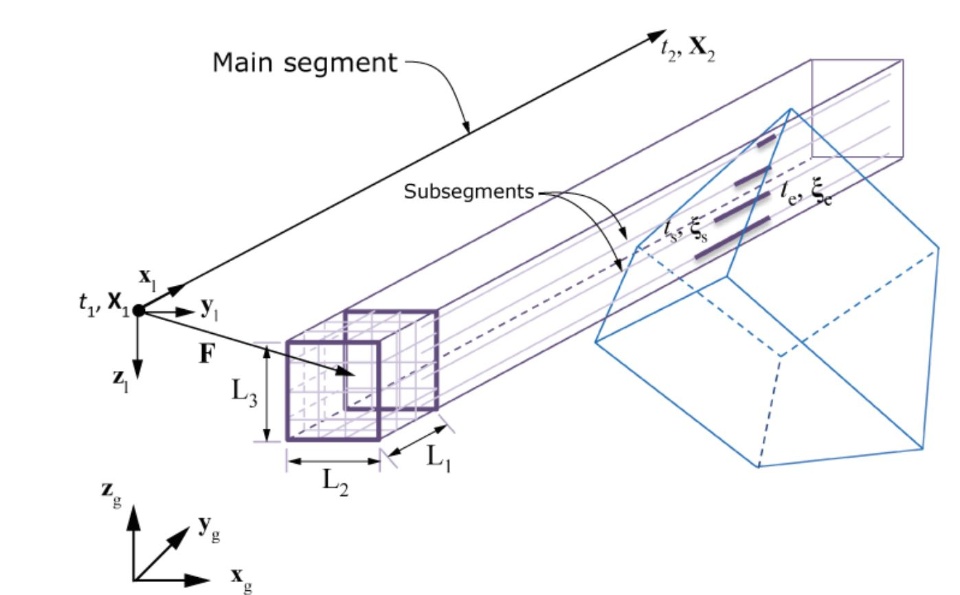

  2. I’m trying to use the Goldak model for heat flux and in the plugin, we need to define values for subdivisions which I don’t understand it. I think it might refer to the number of division in cuboid (picture 2) which divide the Goldak model in Abaqus but if I would be correct, results shouldn’t change from a certain number but it does. For example, I used 50 and 100 for each subdivision direction and I saw the maximum temperature was changed about 150C.

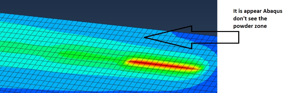

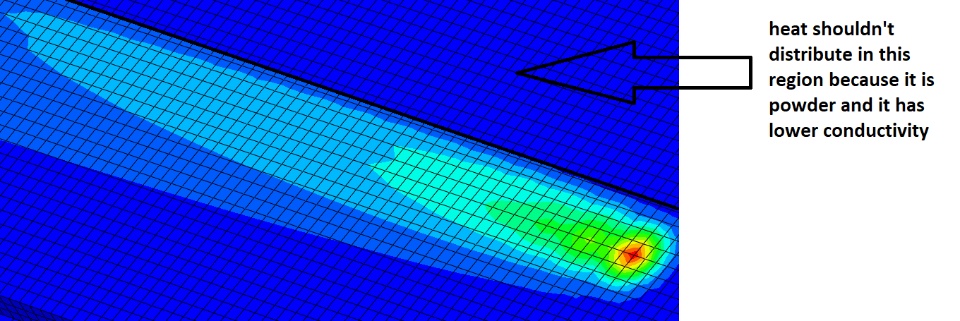

  4. In case of the AM process with the powder bed base, we know conduction in powder is lower the solid-state which create an unsymmetrical temperature distribution witch I can’t see it in the method which Abaqus uses (pic 3 and 4). Would you please explain to me why this happens and is there any way that I can define the powder state for material because we can’t use UMATHT and USFLD for this method.
