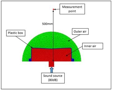

Currently our company have an issue about acoustic analysis. In speccific, we want to measure pressure sound at point with distance 500 mm from sound source . The sound source is placed inside plastic part, you could see below picture for more information. So the question is: is there anyway to measure pressure sound of these point in Abaqus
