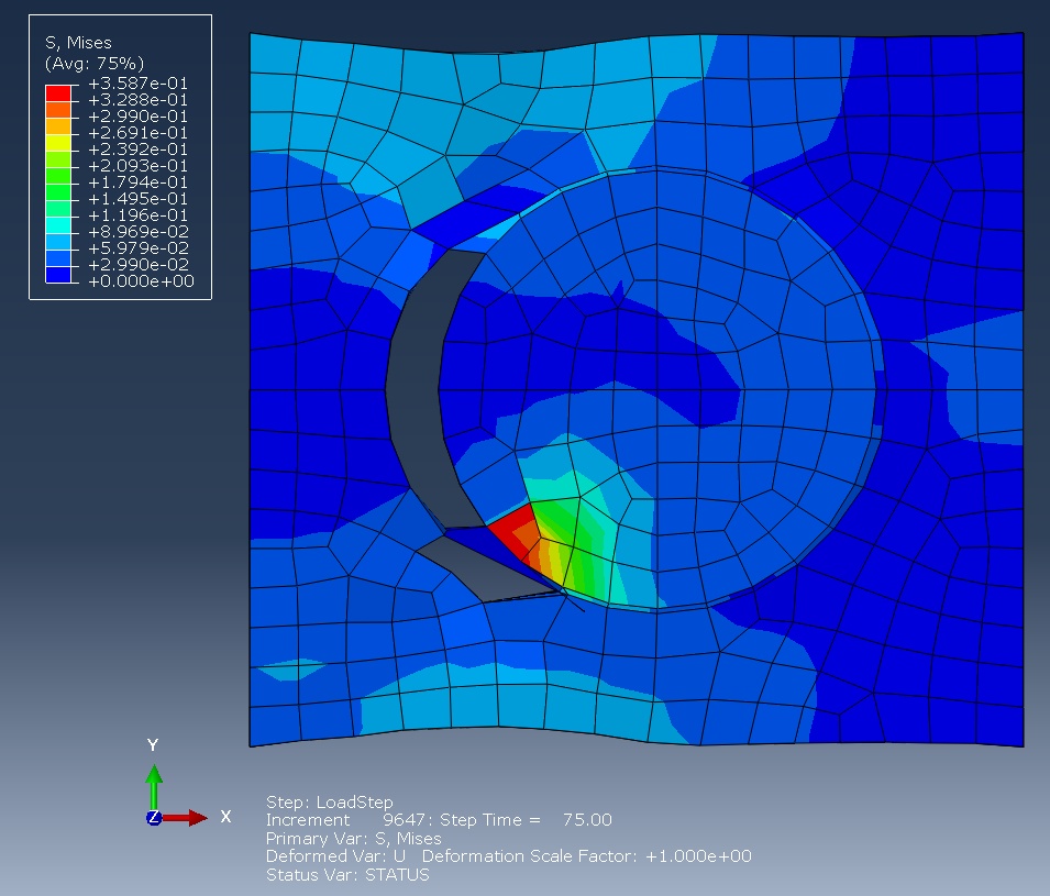

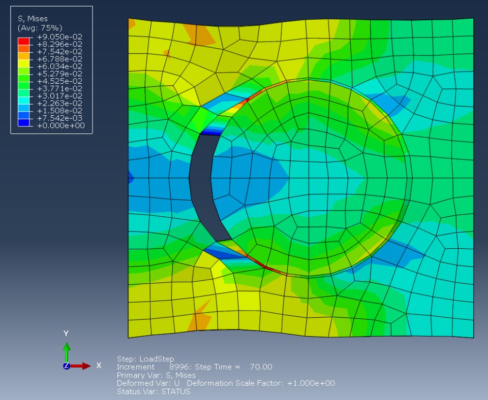

In my case, the kinetic energy starts spikeing half way throughout the failure process. At time 70, the kinetic energy is still low (but the part has already partially failed):

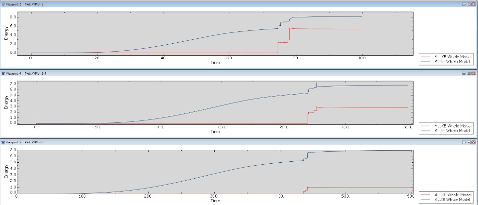

When the spike in kinetic energy appears it looks like this:

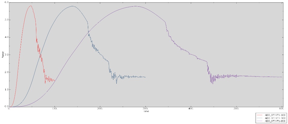

I can adress this "issue" by increasing the time:
However, I am wondering if this is acutally a problem and how would it effect my results?
