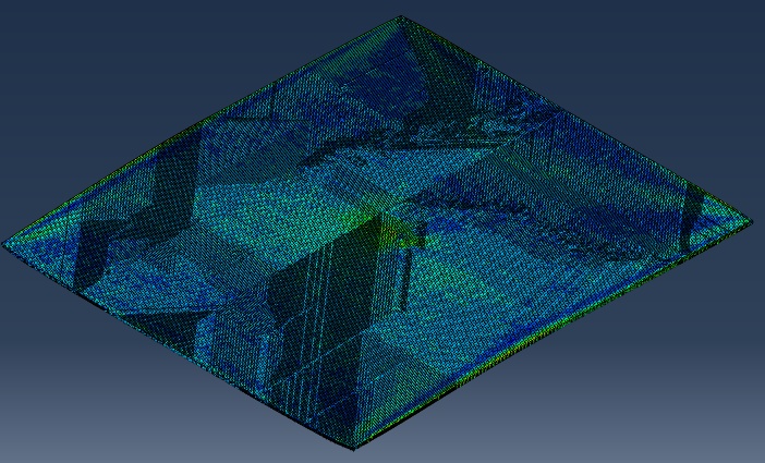

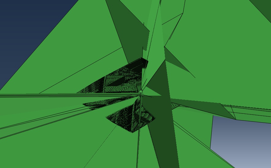

I'm trying to import the deformed part from obd file.

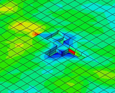

the part was a cold-rolled plate and got void damage in the middle.

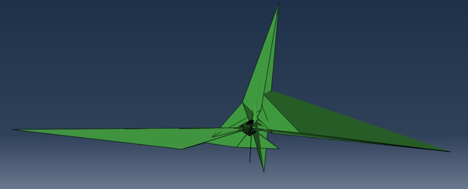

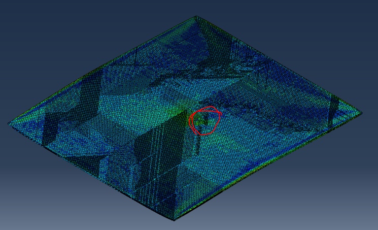

Once I import the part from the obd file, the damaged region excessively stretched...
How can I import the damaged file without the crazy mesh?

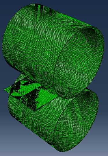

I want the deformed plate to pass through the cold-rolling machine again so that I can see how the void gets enlarged and how the new cracks are created
[Figures]
  1. cold-rolling state
  2. after the rolling
  3. plate status after the rolling
  4. void damage of the plate

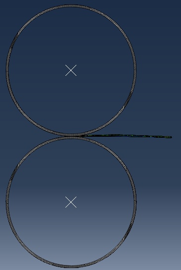

  5. void location on the plate
  6. imported deformed part from the obd file
  7. plate location of the imported part.
