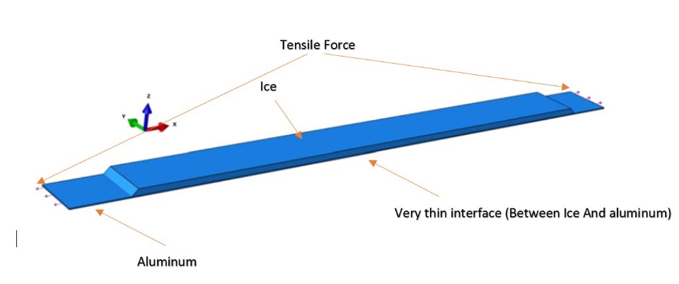

Hello All,
I really appreciated it if you can help me with my modeling.
my Model has three parts, Ice, Aluminum, and Interface (The cohesive zone model). I am using the dynamic explicit in Abaqus. Because my model is symmetry I just consider a quarter of that for modeling. I put the figure of my model to help you understand it better. There is an aluminum surface and Ice was considered at the top of that (at the center of the Aluminum surface). Also, there is a very thin interface between them. there are two questions that I have. First of all, what are the best types of boundary conditions that I can consider in order to consider symmetry boundary conditions on both sides? (Since I consider just a quarter of the model I definitely need to define symmetry condition in two sides) Also, in the steps section, is there anything that I should check or just default setting work? Actually, I ran my model but unfortunately, I could not get any result. No deformation or ice detachment or anything else. I ran my model but after two hours it didn't finish and did not give me any result. I checked the result many times during the simulation but nothing happened.
Thanks
In general, any suggestion will be appreciated
Thanks
