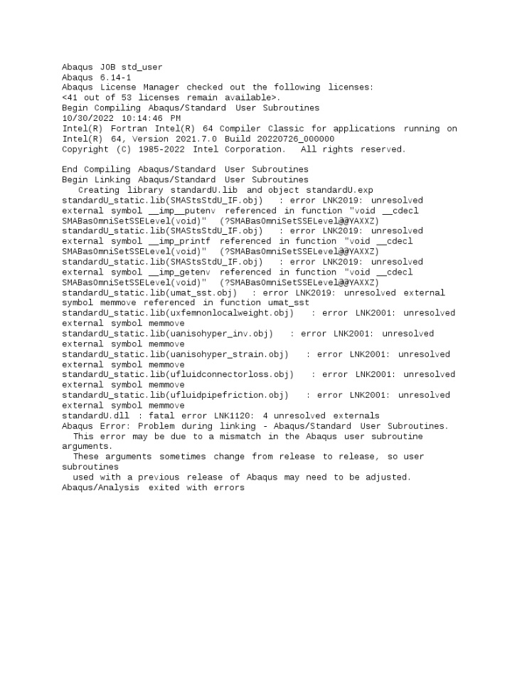

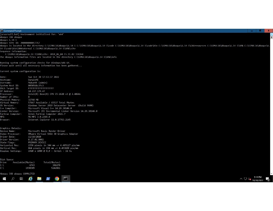

I am trying to link intel one API with Abaqus 6.14 following the instruction on the link below. But I am not able to link successfully. I made changes to the abaqus_v6.env file, abq6141.bat file and added the path to environmental variables. The Fortran compiler gets detected by Abaqus when I try the 'abaqus info=system' command but throws an error when I try 'abaqus veriy -user_std'.

I have attached a pic of the response for 'abaqus info=system' command and the .log file of user_std. Kindly let me know what fixes can be done.
