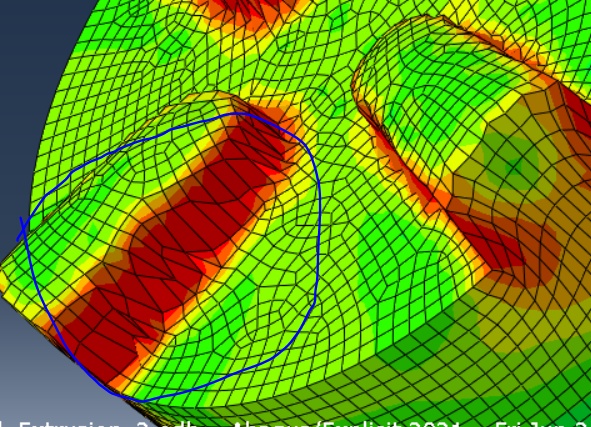

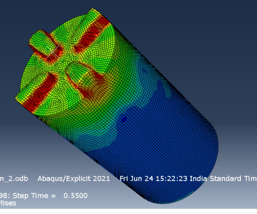

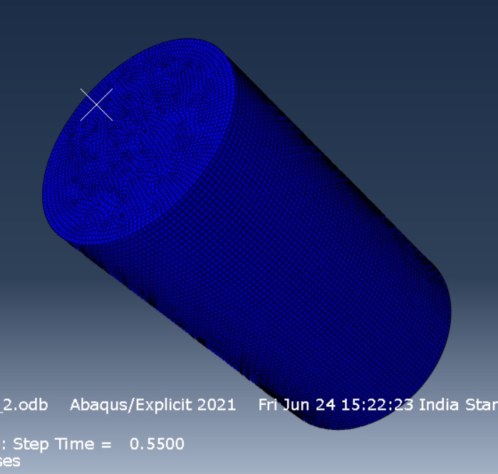

I am doing simple profile extrusion for aluminum billet in Abaqus dynamic explicit analysis, as the the material extruded through the rigid die it is taking the required profile but the elements are getting distorted as shown in images. I need to have the adaptivity the extruded surfaces, i tired applying ALE mesh control and domain but i couldn't achieve the mesh adaptivity the extruded surfaces. can anyone help me to overcome this issue?
