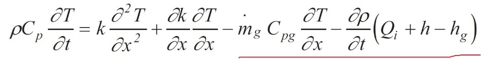

I am trying to add terms (underlined in RED in image "eq") to the heat equation of abaqus in a heat transfer modeling:

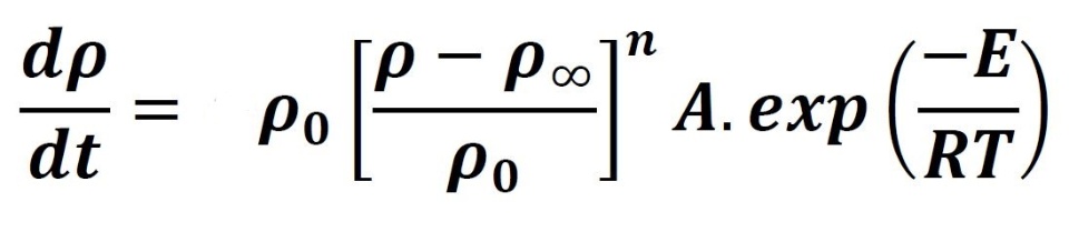

The main issue is the inclusion of dRho/dt calculated by (image "Rho") :
As you notice it is a temperature dependant term, which in fact is the solution of the simulation.

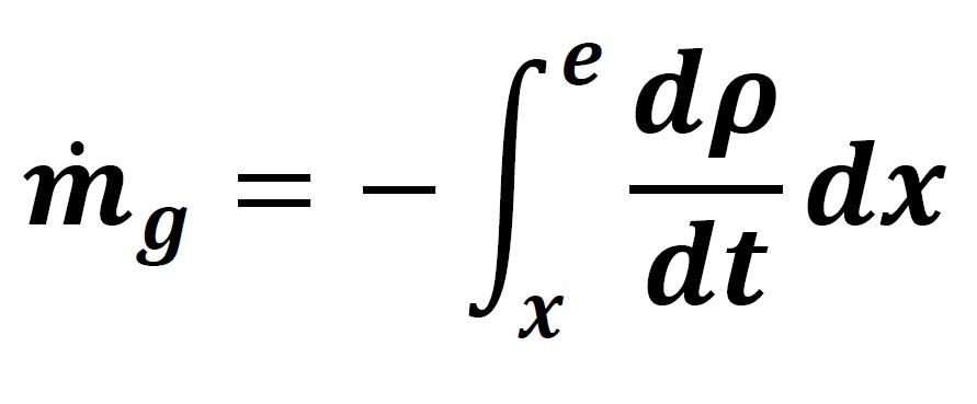

The other issue is Mdot (image "m") :
This term can be calculated once dRho/dt is known.
The other remaining additional terms are known constants.
Kindly help me add these terms, or at least guide me on how to do it and which subroutines to use.
