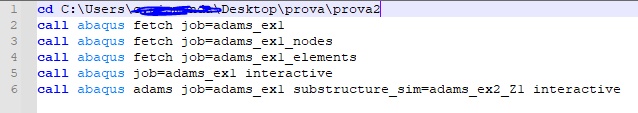

I'm trying to get the Adams .mnf file from an Abaqus Analysis but I can't reach my objective.
I read the Abaqus guide and I followed all the required steps (modal analysis and substrucure generation) but at the end I can't generate this kind of file. For Example, I followed this exercise in the Abaqus Guide https://docs.software.vt.edu/abaqusv2022/English/SIMACAEEXARefMap/simaexa-c-adams.htm
In my batch windows file (launch file) I wrote the sentences that you can see in the picture, but at the end I don't have my .mnf file.
How can I solve my problem?
