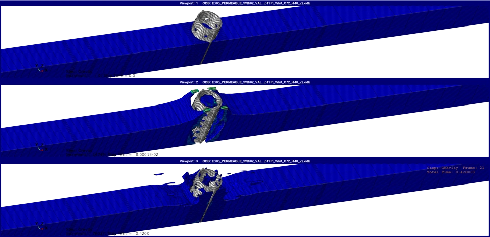

I’m using Abaqus/Explicit with CEL (Coupled Eulerian–Lagrangian) to simulate a permeable cylindrical breakwater in a wave flume. The goal is to evaluate hydrodynamic loads and the structural response of the breakwater.
Issue: In some runs I observe strong local free-surface disturbances (jet/spray-like behavior and detached fluid islands) already during the gravity initialization step, i.e. before wave generation starts. Many simulations run fine, but occasionally the solution develops these disturbances early on (and rarely again later). So far I couldn’t identify a consistent root cause.

- Attached figure shows the evolution of the issue
