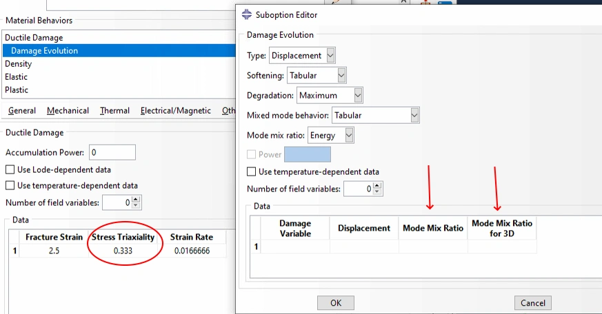

Maybe this is a total noob question, as my thoughts took a wrong turn somewhere, or I misinterpreted the documentation, and I hope someone can clarify to me the meaning of the two columns describing the 3D dependency for the ductile damage - damage evolution tabular.
I am trying to model a microstructure consisting of a matrix and some inclusions. For the matrix I'd llike to include some damage model incl. element deletion. Von Mises plasticity is sufficient in my case, and I was hoping to use "ductile damage". For ductile damage, the damage initialization can be easily entered in dependence on the triaxiality factor, as shown in the screenshot below. However, for damage evolution i don't get how phi1 and phi2 are defined for an element or an integration point respectively.
In the documentation, I couldn't find a clear statement what these "Mode Mix Ratios" mean for a volume element.

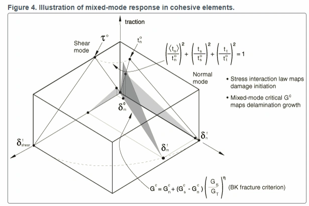

  • https://help.3ds.com/2025/english/dssimulia_established/SIMACAEELMRefMap/simaelm-c-cohesivebehavior.htm?contextscope=all
    which had the most useful information. However, this is written for a cohesive element, where the normal direction is clearly defined. In my case, ductile damage => damage evolution, a "normal direction" is not really defined. So what do the directions n,s,t translate to when I am not using a cohesive but a general tet element? I am having issues understanding what the normal and two shear directions mean at the integration point of a general tet or brick element.
    What I have available as data is stress strain curves with different triaxialities (parameter or lode angle) including stress tensor and strains/displacements from lower level simulations. But I have simply no idea what to put in this table for phi1/phi2.
