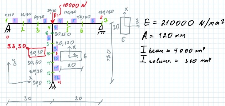

I have calculated the presented below frame in Abaqus and by means direct stiffness matrix method.In Abaqus I have used beam element B23.

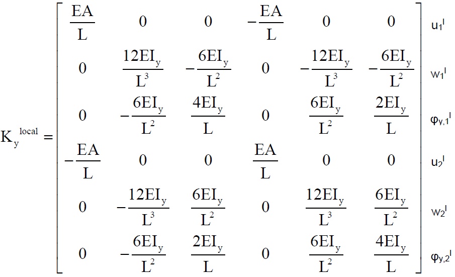

For direct stifnessmatrix method I have used the following element stiffness matrix:
As I remember this element stiffness matrix is Euler-Bernoulli beam. The beam element B23 in abaqus is also Euler-Bernoulli beam.
If I calculate my frame as it presented by means of both methods the deviation of results (displacement) is maximum 0,01%.
But if I change the x-coordinate at node 10 from 90 to 93 mm, the deviation of results incresed to almost 8%. It depends on which node I want to compare. By means of changing x-coordinate I want to model a geometrical imperfection.
In direct stiffness matrix method I use the Newton-Raphson method to calculate displacements.
Maybe some one could shortly explain why in the first case the difference is so small and in the second one so big?
