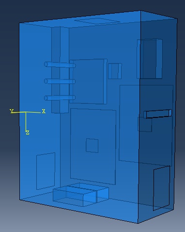

This is a fluid domain I created based on the structure
[Update]
One more thing...the thermal energy condition takes element sets only. Is there a way to convert geometric set to element set?
