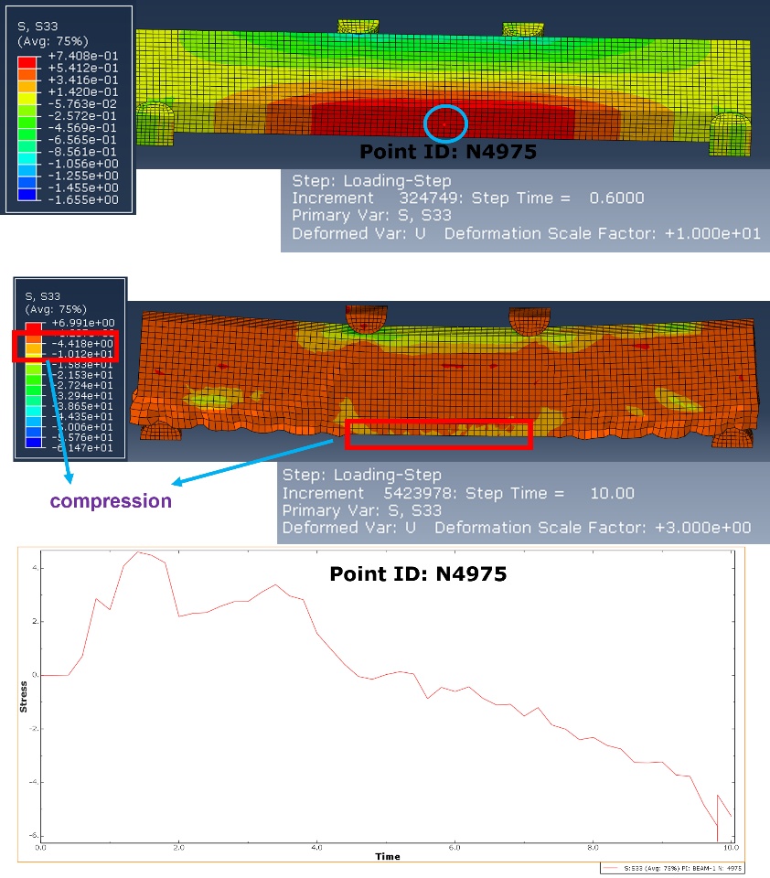

Using the CDP model, I modelled an RC beam for a 4-point bending test. I followed all the instructions as explained in an example in the literature. The beam was loaded for 10 sec. I observed that the tensile region in the bottom of the mid-span turned out to be a compressive region as crack develops and propagates.
How could it be possible even though the beam is still under loading? Please find the attached images showing the stress distribution (S33 in a longitudinal direction perpendicular to the X transverse - Y vertical surface) at 0.6 sec and 10 sec. As of the fourth second of the analysis, the compressive stress comes out and starts increasing despite loading as can be seen from the stress-time curve.
