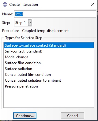

Dear All,
I am interested in inducing a cavity radiation interaction between parts during a coupled temperature-displacement step. However, this option is not available within Abaqus 2021 (cf. image). I watched the Abaqus 2022 new features Tech Talk but did not notice an update to cavity radiation accessibility. Is this functionality on the agenda for future releases? I would like to avoid employing a partitioned analysis approach in the future (Figure 3 in https://iopscience.iop.org/article/10.1088/1361-665X/aabbe8/meta).
