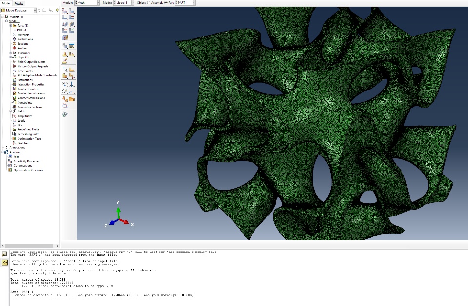

Hello,
I am trying to mesh a TPMS surface in MATLAB which generates a decent tet mesh but when imported into ABAQUS and a mesh verify command is run, ABAQUS returns 100% errors in the elements. I have unticked all the shape and size metrics just to check if I can bypass the in-built mesh verification but it would still return the same errors. I have tried refining my mesh but the same error persists. Can anyone give me a lead into what might be going wrong? I am curious about attaining a decent mesh to work with and I thought the mesh I generated on MATLAB was decent but ABAQUS nullifies my thought.
