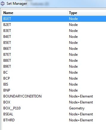

Abaqus CAE: Node+Element Set
The Abaqus documentation states that the input file can have a node and element set with the same name. On my coworker's CAE file I am working on I am seeing that there is a set that is a combination of Nodes and Elements, but I don't see how to define that in CAE. How is a "Node+Element" set created in CAE?
