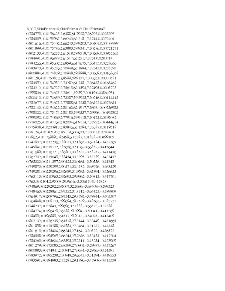

I see how to apply a non-uniform pressure in Abaqus but I struggle to apply the viscous stress. I am looking for a way to apply a non-uniform vector field on the 3D model from a *.csv file. Such a file is linked to this post, there are 6 columns in it. 3 for the application point of the force and 3 others for the force components. Is there any solution to my problem ?
