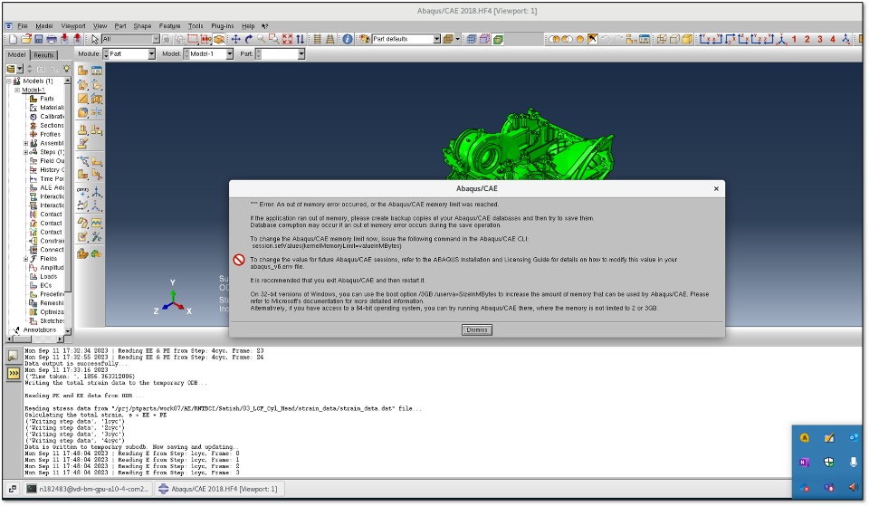

We have created a ODB and writing a Tensor data at the nodes.
There are 4 steps each includes 24 frames for 27k nodes.
So, the data size is very huge --> (272107, 96, 6).
When we are writing this data, we checked the memory usage using following
option:
session.kernelMemoryFootprint
For every frame it is writing the data, the memory usage is
increasing by ~300MB. At the end, the total memory usage is ~25-30GB.
Could anybody please explain why this much memory is required here?
Secondly, I thought closing the odb will release the memory,
however, then also the consumed memory usage (~25-30GB) is NOT released.
Due to this high memory usage, Abaqus/CAE is crashing.
How can we release this memory?
