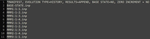

I tried to run multiple (48) load cases with the keyword *Manifest. The main input file is structured as below,
keyline1: *manifest keyword
keyline2: base state of the model as an input file
keyline3 to 50 : input files for different load cases

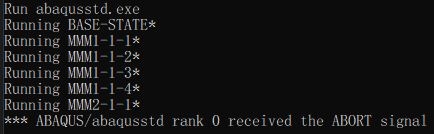

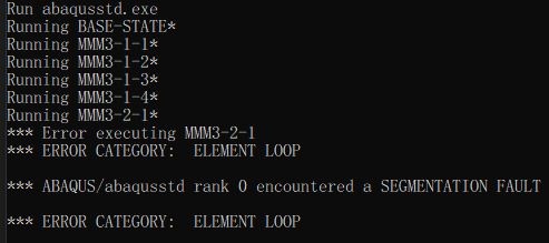

Once the analysis runs, it completes the few load cases (few input files) and gives either of the following two errors:
"ABAQUS/abaqusstd rank 0 received the ABORT signal"
or
"ABAQUS/abaqusstd rank 0 encountered a SEGMENTATION FAULT"
