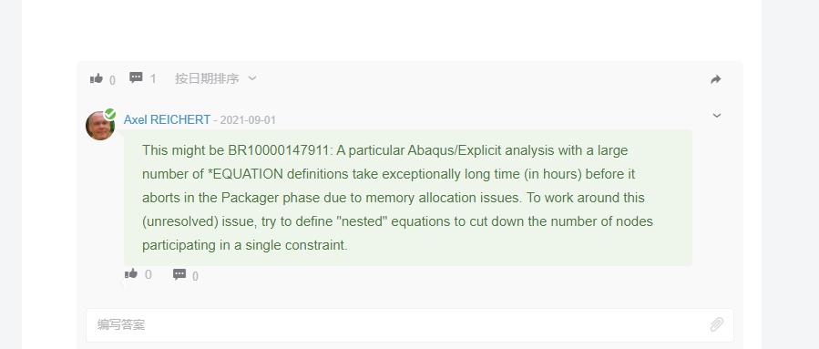

I noticed that an expert named Alex REICHERT answered a similar question by saying that
" This might be BR10000147911: A particular Abaqus/Explicit analysis with a largenumber of *EQUATION definitions take exceptionally long time (in hours) before it aborts in the Packager phase due to memory allocation issues. To work around this(unresolved) issue, try to define "nested" equations to cut down the number of nodes participating in a single constraint."
