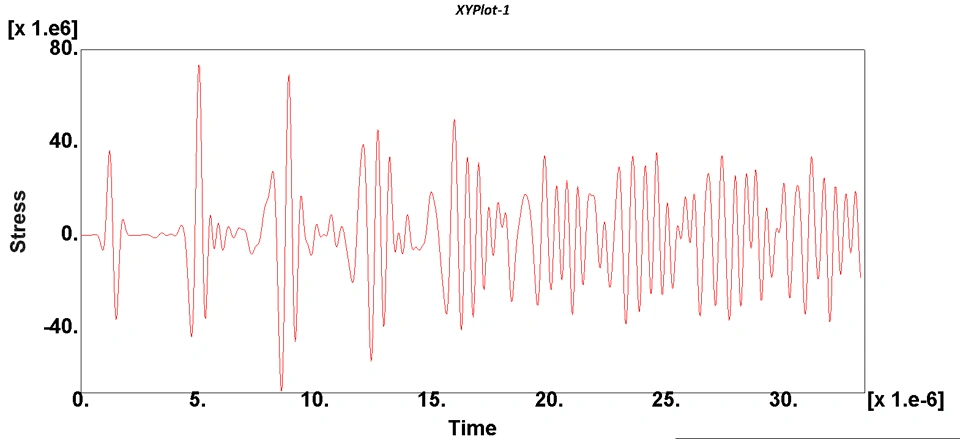

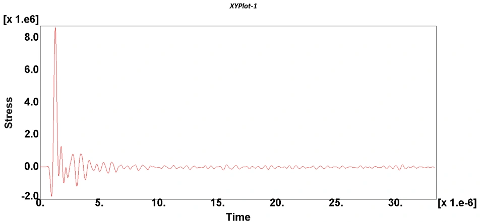

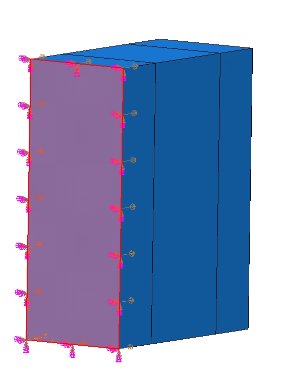

I’m currently performing an elastic wave simulation in a 3D cuboid-shaped multilayer structure. To excite the wave, I applied a velocity boundary condition (BC) to the model in two different ways:
  1. Applied over an entire surface (as shown in Figure 1), and
  2. Applied at a single point (as shown in Figure 2).
However, when I plot the stress component σ₁₁ (S11) versus time using field history outputs, the resulting graphs differ significantly. Figure 3 shows the elastic wave pulse that was used in both cases.
This leads me to ask:
  • Could the method of applying the boundary condition be the main reason behind the difference in the plots?
  • Are there any other possible reasons that might explain the variation?
  • Most importantly, is there any standard way to validate these stress–time plots obtained from the history output?
For your reference, I’ve attached:
  • Figure 4: Stress vs. time plot when BC was applied to the surface, and
  • Figure 5: Stress vs. time plot when BC was applied to a single point.
