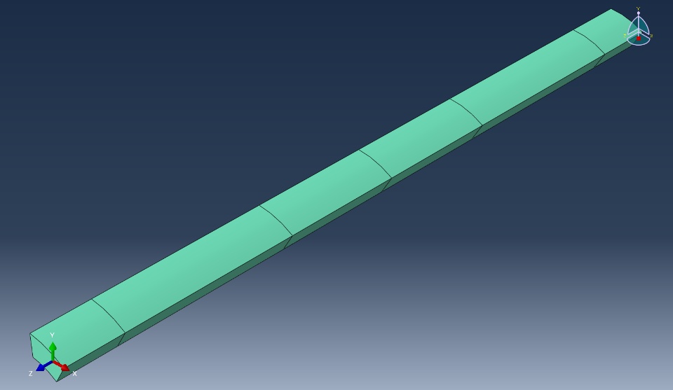

I am attempting to model the distension of a reinforced cylindrical rubber tube that is under pressure. Despite being axisymmetric this part must be modeled in 3D due to the presence of the fibre reinforcement families that run in the longitudinal and hoop directions (more background here).

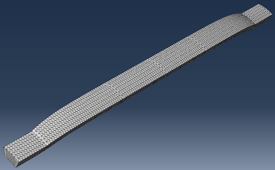

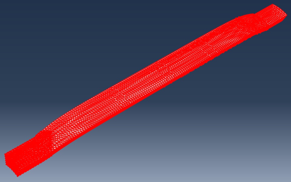

First I make a new part using the deformed configuration of the initial part's .odb file, which gives me an orphan mesh of the deformed part. Then I use Plug-ins->Create geometry from mesh to assign a geometry to the orphan mesh. This brings me to my problem: the resulting part appears to be an amalgamation of thousands of smaller tetragonal elements, which I cannot work with at all. Any attempt to select an edge (e.g. to create a set for measuring displacement) by clicking and dragging a box over a portion of the part appears to select the entire part as a default (shown below). Abaqus also does not recognize any groups of elements as coherent surfaces either, meaning I cannot easily highlight surfaces (e.g. to apply boundary conditions or loads). I also haven't even bothered trying to apply my cyclic symmetry conditions or discrete orientation for specifying the fibre directions later.
