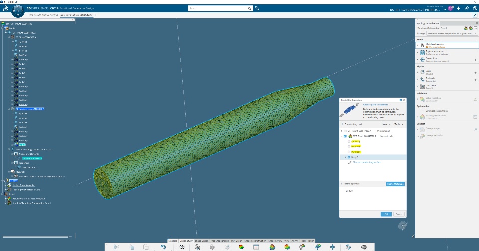

I'm struggling with optimization in "Funtional Generative Design" app by 3dExperience.
As you can see in the picture below, I want to optimize the yellow cilinder. With this cilinder there are bodies (the 3 highlighted part bodies) that I want to include into the analysis (with a TIE) and that are not part of the optimization but are necessary to apply boundary conditions.
When I try to include these parts, I simply can't...it's like I just can optimize one body at a time.
I can't add any more contributing part.
How can I include these bodies into the analysis as simple "contributing part" (not object of the optimization, but necessary to apply boundary conditions)???
