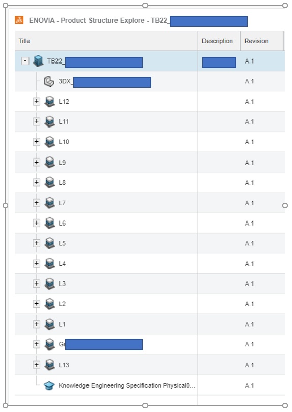

Current practices:
- 100’s of 3dshapes as Skeletons.
There are many cases where no geometry is found in a skeleton at this level
- 100’s of KES objects through out the product structure.
For either case it is possible to avoid this practice.
Q1: if these objects can be eliminated will this improve the performance for ENOVIA web client users?
Q2: where is it best to spend time and resources?  server performance or modelling Best Practices?

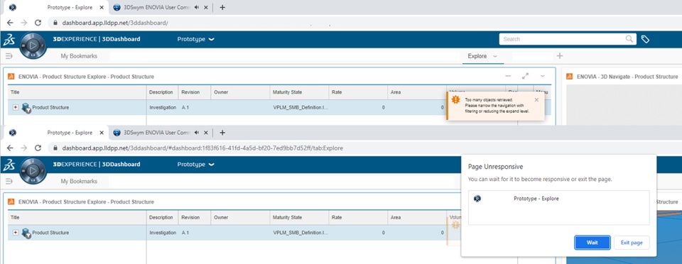

Web Client users current experience is very poor.  They see the following messages frequently.
