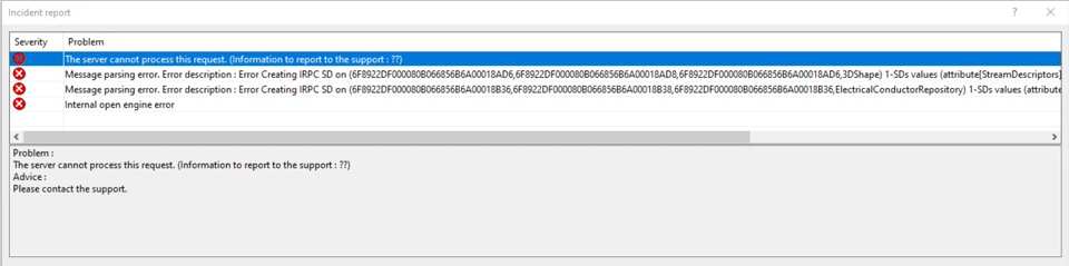

I have also tried the JPO API - DomainObject.cloneObject which clone a business but having an issue while opening the CAD in Native app.
