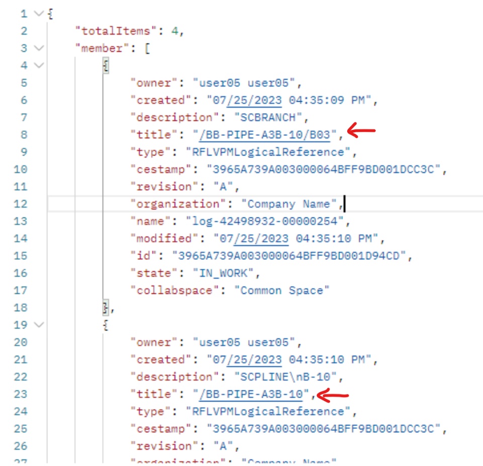

I'm asking this because I use the search webservices (Logical, Documents, etc) and when I search for an item with a certain title, I often get more than expected (which correlate to the example given on the help page)
For example: when using /resources/v1/modeler/dslog/dslog:LogItem/search?\\\$searchStr="BB-PIPE-A3B-10" I would like to only get 1 output which is the item that holds that exact title, but I get 4 items because some of my logical items contain part of the title I searched:
Question: is there an option to make sure the search only returns the item that exactly holds the title i'm searching for ? I tried to use the double quotes and other settings available from the help.3ds but I couldn't restrict the search.
This is important to me, because in my context, the only attribute I know for sure is the title of my items, and if that title is in 4000 items, sorting all of them to just get one item is not practical.
